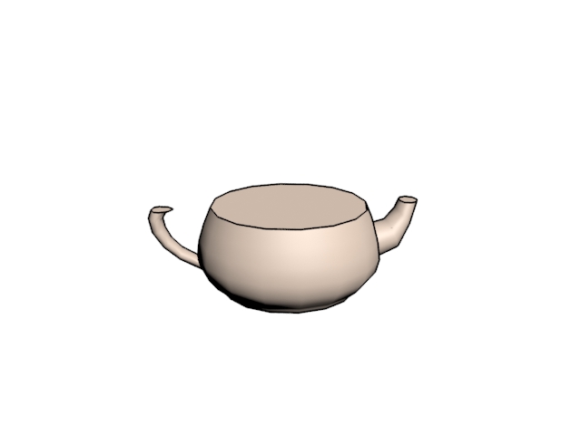

    Been using Vray toon a bit lately and had a couple unexpected problems. This is a test render with normal settings. This is Vray 3.00.02 and Max 2014.
    First is when using Object Visibility, I was hoping it would either leave the ink black and fade the object, or fade the object and the ink by the same amount. Instead, this happened.

    All of these are known; what I don't know yet is how to solve these issues The toon generally only finds out if there is an object or not, but there is no easy way to determine if the part of the object that is hit is invisible or clipped away. I keep coming back to this occasionally but a good solution has not occurred to me yet.
    Btw - the VRayVrmatMtl material allows you to create a toon material - maybe it will work better for some of these cases than the global atmospheric effect.
