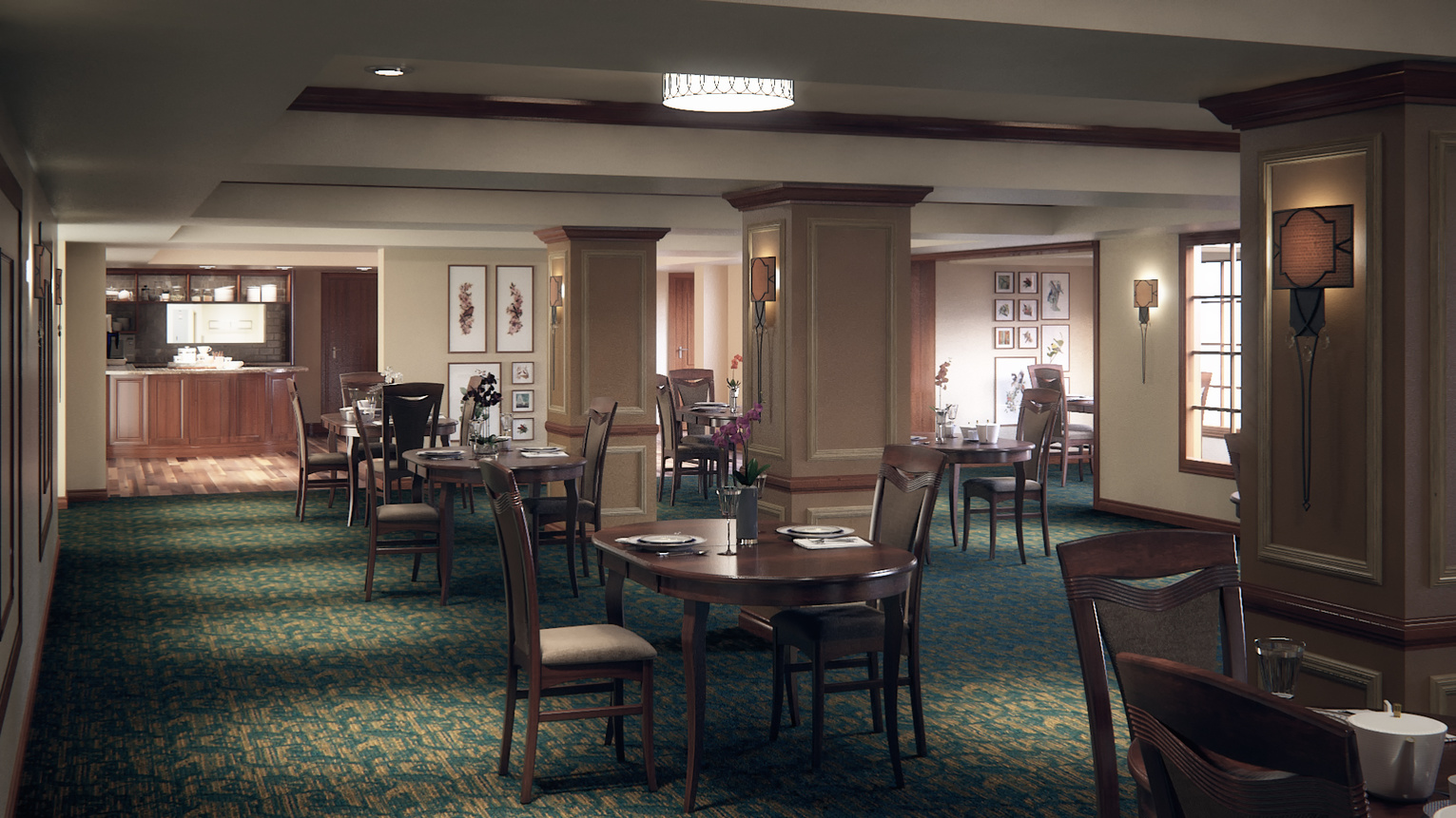

                    • #40
                      I am having a heck of a time here. Low resolution and noise in 2 hours.
Name:	la cholla.jpg

                        • #42
                          As an aside, the render looks great. I don't like interiors that have a lot of middle brightness colours as they tend to suck a lot of the light out of the shot, I'm more of a light and airy person. I think it's kind of hard to get something with this properties to look realistic but you've done a great job of it here. Your interior / exterior lighting balance works really well.
                          • #43
                            Thanks! I totally redid the lights. It seems that when you get everything right V-Ray is happy. I basically turned everything off and turned things on one by one, until everything balanced. I'll post an update tomorrow.

                            • #44
                              It does have a very nice photographic feel to it. Nice work.
                              • #45
                                thats pretty nice lighting!
