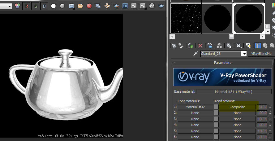

    Hi,
    I am trying to create a rusted metal
    a) metal is a very simple refelctive VRaystandard.
    b) for the rust material I use a bitmap for another VRaystandard in diffuse.
    c) I blend the a) and b) using VRayBlend with Composite as blend mask (a VRayDirt + Bercon noise map)
    Not sure it was just me or a bug. When I render out this VRayBlend material, the blend mask seems not working. While I use this blend mask in diffuse (another VRay standard material), VRay are able render out the texture correctly.
    Am I do anything wrong?
    Chen

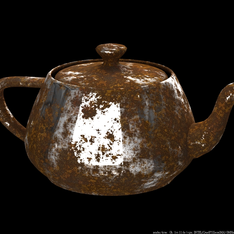

    This is the effect I am after (image attached), except I want the rust limit in the region of VRayDirt, not just uniform scattering on surface of teapot. Somehow I just can't make it happen..
