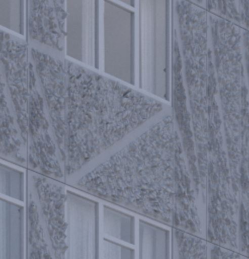

    Is there a way to make sub triangle edges invisible for VRayDisplacementMod (3D mapping)?
    Please see attached. Last image shows texture I'm using for displacement: cellular masked with VRayEdges (tried VRayComp, Mix, Composite but no luck so far)

    Hm, we really have to work on that. I guess we really have to separate the map into an edges texture map and a rounded corners map - the two functionalities are messing each other up in cases like this.

      Is it possible to split it for the upcoming SP3 final release?

        Possibly... I will try.

          Thanks for reply.
          I wouldn't mind rounded edges/corners feature being separate Mtl like VRayBumpMtl.

            That would be great.
            +1 for that rounded corners/hard edges texture.
