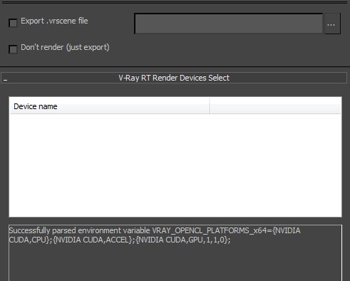

                          I updated the driver to the last one (359) but it doesn't change anything.
                          No device are listed in the V-Ray RT.

                            Originally posted by savage309 View Post
                            For the stable version there will be a UI button.
                            For now, you can either navigate to the V-Ray install path (by default C:\Program Files\Chaos Group\V-Ray\RT for 3ds Max 2016 for x64\bin), open a console there and type "./vray -server" or find the "Launch V-Ray render slave" from the Windows start menu (screenshot attached).
                            [ATTACH=CONFIG]27226[/ATTACH]
                            I don't have this shortcut on my workstation neither the command prompt C:\Program Files\Chaos Group\V-Ray\RT for 3ds Max 2016 for x64\bin ./vray -server return an unknown command.
                            • #15
                              Yes if you run the command from arbitrary place it will need to be formatted like that (mind the quotes)
                              "C:\Program Files\Chaos Group\V-Ray\RT for 3ds Max 2016 for x64\bin\vray" -server
                              If this doesn't work, please check for "Launch V-Ray render slave" shortcut located in "C:\ProgramData\Microsoft\Windows\Start Menu\Programs\Chaos Group\V-Ray for Maya 2016 for x64".
