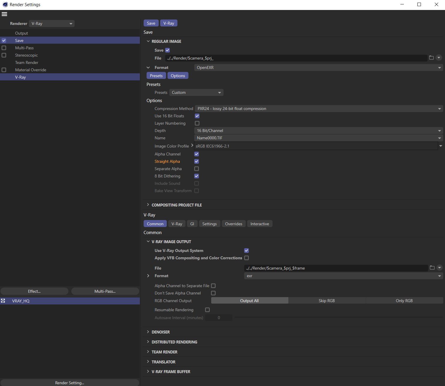

            • #21
              Hi Doger
              We mainly use the c4d beauty files for previews, because we save the files from the v-ray output system as multichannel exr-s. But these are slower to work with for simple previews and edits.
              1. you have to name the "regular" beauty image different from the one you will use for for the v-ray output system
              2. have to disable c4d -s multi-pass output system
              3. you have to add a Current frame token $frame to the vray output system file name. Otherwise it will overwrite each rendered frame with the current one. most of the time we add "multipass", MC or MP or something similar to the file names of the v-ray output system. just to make them a bit easier to find in a folder. (these few letters are missing from the screengrab i've attached)
              V-ray will warn you that saving both the regular beauty and the v-ray output system images can cause issues but it wont.
              We add the files to the render queue and render with team render.
              I attached an image for the setup we use. keep in mind when using the render queue doesn't accept "relative paths" with tokens so if you use relative paths you have to replace the save location with the absolute save location you want to use.
