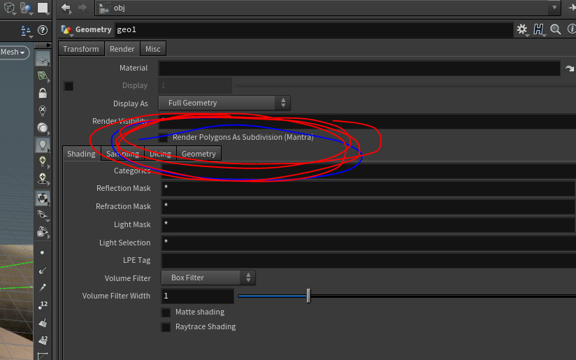

        Curious why V-ray doesn't have a button like this... "Render Polygons as Subdivision" V-ray (not mantra) -- The displacement > but turn off displace and render as subD works well.

              Okay I actually found the object properties on the shelf when selecting geo adds an extra tab to the geo parms and then I can set it to render as SubD much like the mantra way.
