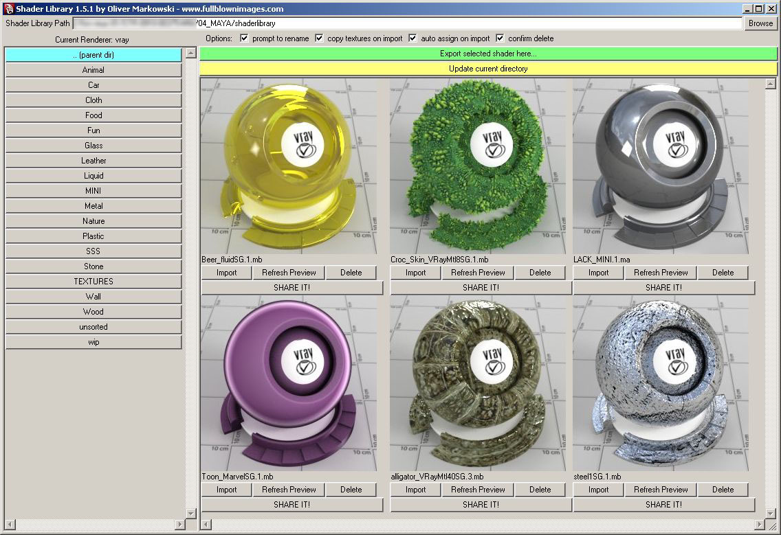

          Please re-download....it should now say version 1.5.1 in the window title...besides the bugfix I added one more requested feature
          Code:
          Changes in Version 1.5.1
          [BUG] IMPORT was temporary screwed up...hope this is fixed ... THX TO JENSL from chaos-forums for reporting this bug!!
                  also added more debug info...
          [REQ] option to "auto-apply" the imported shader to the current selection - requested by throb...
          NEW INTERFACE:
