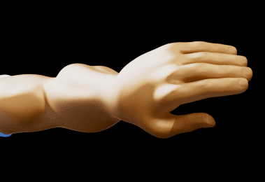

          I am referring to VRayToonMtl and yes, the difference appears locally. Here is a small crop of my character with the issue shown. The darker more contrast version is bucket rendered, the lighter one is IPR.
            I managed to reproduce the differences using Area lights (i.e. VRayLights and Maya native Area light; where there's some form of gradient between the Diffuse Ramp colors). I've logged it for developer investigation (internal bug-tracker id: VMAYA-10983). I don't think there is a direct workaround to the issue; you may need to readjust your lighting/VRayToonMtl so as to render a satisfactory Production rendering result.
