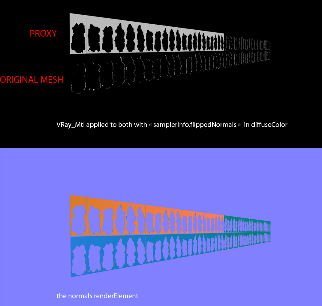

    I'm having difficulties with getting good normals on my Animated proxy.
    All is working good on my original mesh, but when I export my proxy, it seems like half of my geometry have flipped normals.
    let me show you:
    I also have to let you know that the mesh is a DMM glass sim.
    I tried with non-animated proxies, with unchecking export velocity etc etc. But the problem remains.

      yes i tried that, it has no effect.
      I was wondering if I could cheat this normal issue in my shader.
      I tried a lot of things, with blend materials, samplerInfo and condition nodes, but without success..

          I tried that several times, you can see tha tthe original mesh have good normals.
          The problem is due to the proxy
            Do you have some "scale -1" on some transform ?
            Or "opposite face" on shape ?
            www.deex.info
              I freezed transform everything.
              Thanks bigbossfr, my DMMDriven shapes had Opposite Face
              My bad
