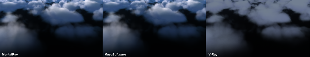

    I try to test fluids in V-Ray 2.30.01 in Maya 2013 SP2 and V-Ray output looks like flat lighting.
    Is there something what i am doing wrong, or special setup needed ?
    It's a simple scene: Visor > Fluid Examples > CloudsAndFog > AfternoonClouds.ma
    Make sure you have real lights on the scene with turned on shadows. The fake lighting inside the "Lighting" rollout is not supported.
    V-Ray/PhoenixFD for Maya developer
      There are no lights in the example scene. Also, you might need to add the V-Ray fluid shading attribues and increase the diffuse multipler to get a closer look to the Maya software renderer.
