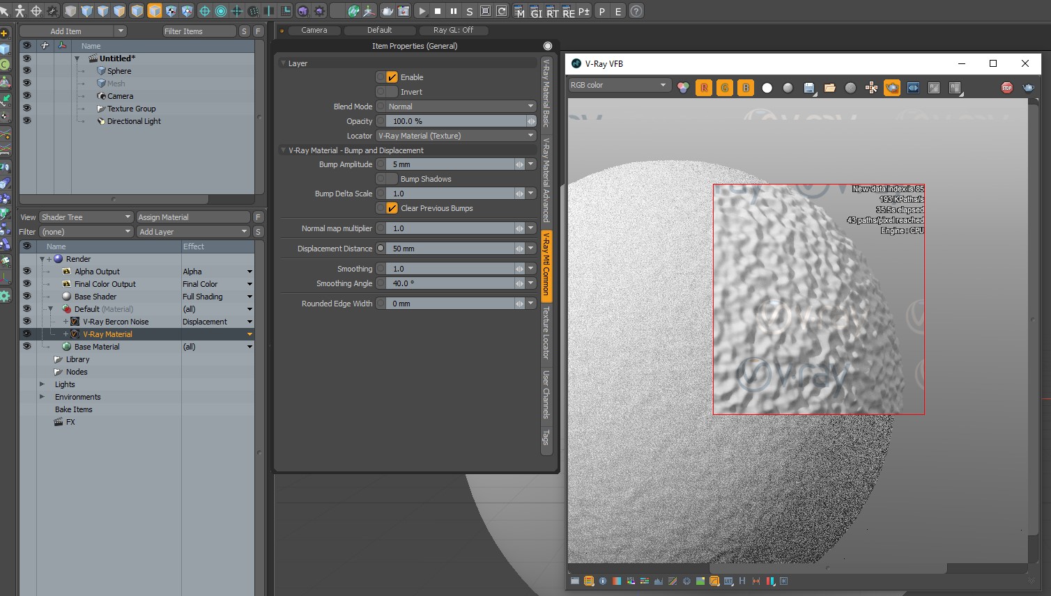

          Hi every one, I am trying to do a displacement with Vray, but I cant figure out how it works. Do I have to use the Modo displacement, or is there any specific Vray material that I have to use ?

            • #36
              Originally posted by Muhammed_Hamed View Post
              Hi Muhammed thank you for your answer, I already had a look at the documentation, but unfortunatly that doesnt help me that much, because I already tried what was in the documentation, the displacement didnt worked, but today I wanted to give another tried, and it has worked, it looks like that I had a bug of refresh of the RT renderer when I was working on my material.
              Thank you for your help.
              Franck
              Edit : well I do some modification and again it doesnt work. I want to be sure of something, Is there a Vray displacement material ? Or do you just specified that any material is a displacement in the shader tree and change its properties in the Vray Geometry properties.

              • #37
                Franck
                Yes even without using the geomtry properties..Set surface shading to Displacement like this
                Best
                Muhammed

                • #38
                  [ATTACH=CONFIG]37783[/ATTACH]
                  Best
                  Muhammed
                  Thanks a lot for your help. Now I see my problem, I dont have this Vray Mtl Common option in the shader tree when I select my material, I only have the Vray Geometries properties. Well I have to investigate on that one. Again thank you a lot for your help.
                  • #39
                    Ok, after investigating further, it looks like that I have a refresh bug with the RT Renderer.
                    • #40
                      You are welcome!
                      The common option properties should be there for any Vray material. You can control,bump,normal mapping and displacement amount there.
                      What version of Vray are you using? Sometimes you will have to restart RT for changes to take place!

                      • #41
                        I am using the last nightly. You are right to make it works I have to stop and restart the RT, but for displacement it is always, not sometimes, that's a bit slowing the work. Again thank you for your help and kindness.
