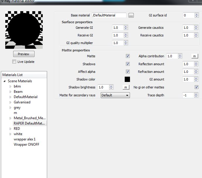

    Originally posted by Micha_cg View Post
    I tested the Wrapper material and it works great, no need for soft edge transparency to match the ground material with the background.
    A little wish - please set the default values so that it take the env as texture. I hope my settings at the screenshot are all right.
    Should the matte workflow not allow to get an alpha channel with shadows? I get the standard alpha look only, the ground plane show no shadows at the alpha. Did I something wrong?
    Thank you for the adding this tool!

      The material is finalized. You need to change the alpha contribution to -1 if you what to see the correct shadow in the alpha channel.

        I do that but can't see anything..
        It's true- my shadows are not sharp from sunlight but soft diffuse one on the floor- rather gi with slight shadows.
        Can you please see the screen shot in case my setup is wrongClick image for larger version

        • #19
          Try -1 instead 1.
