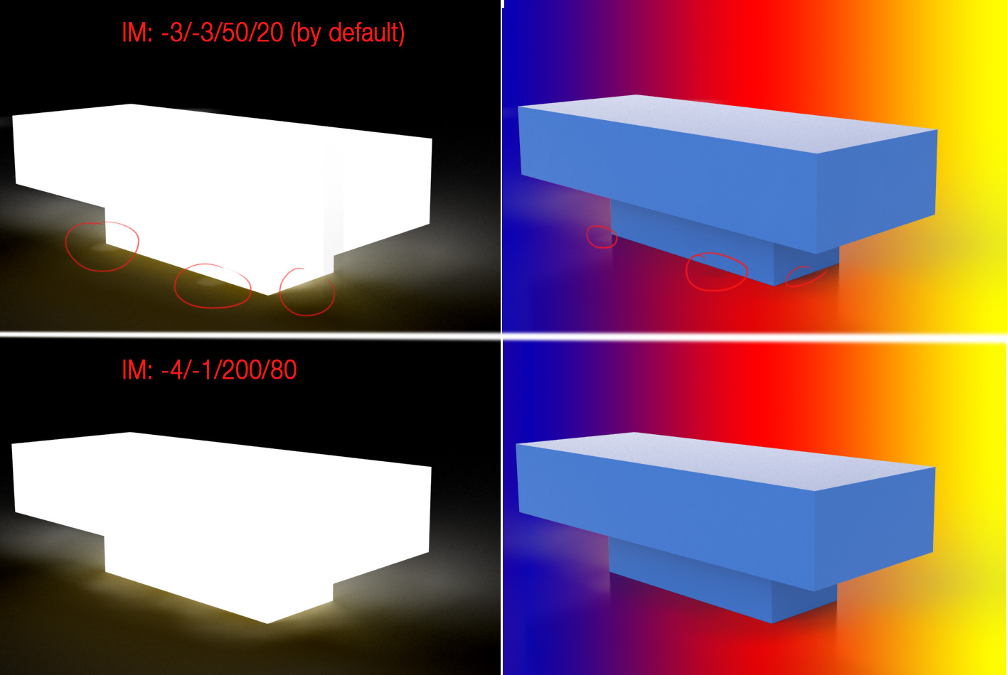

        Ok, I managed to use domelight with hdri (nothing in env.) and to avoid the thin overlay that sucks the alpha. Simply set a black TexAcolor as GI for the base material (the one set in wrapped material). Unfortunately it brings unwanted marks but increasing settings for IM helps (see attached image). It is still not 100% perfect but acceptable. Hope it can be improvedClick image for larger version
Name:	wrapper material with dome.JPG
ID:	846686 ps. subdivisions for dome light does not help but I keep it 32
