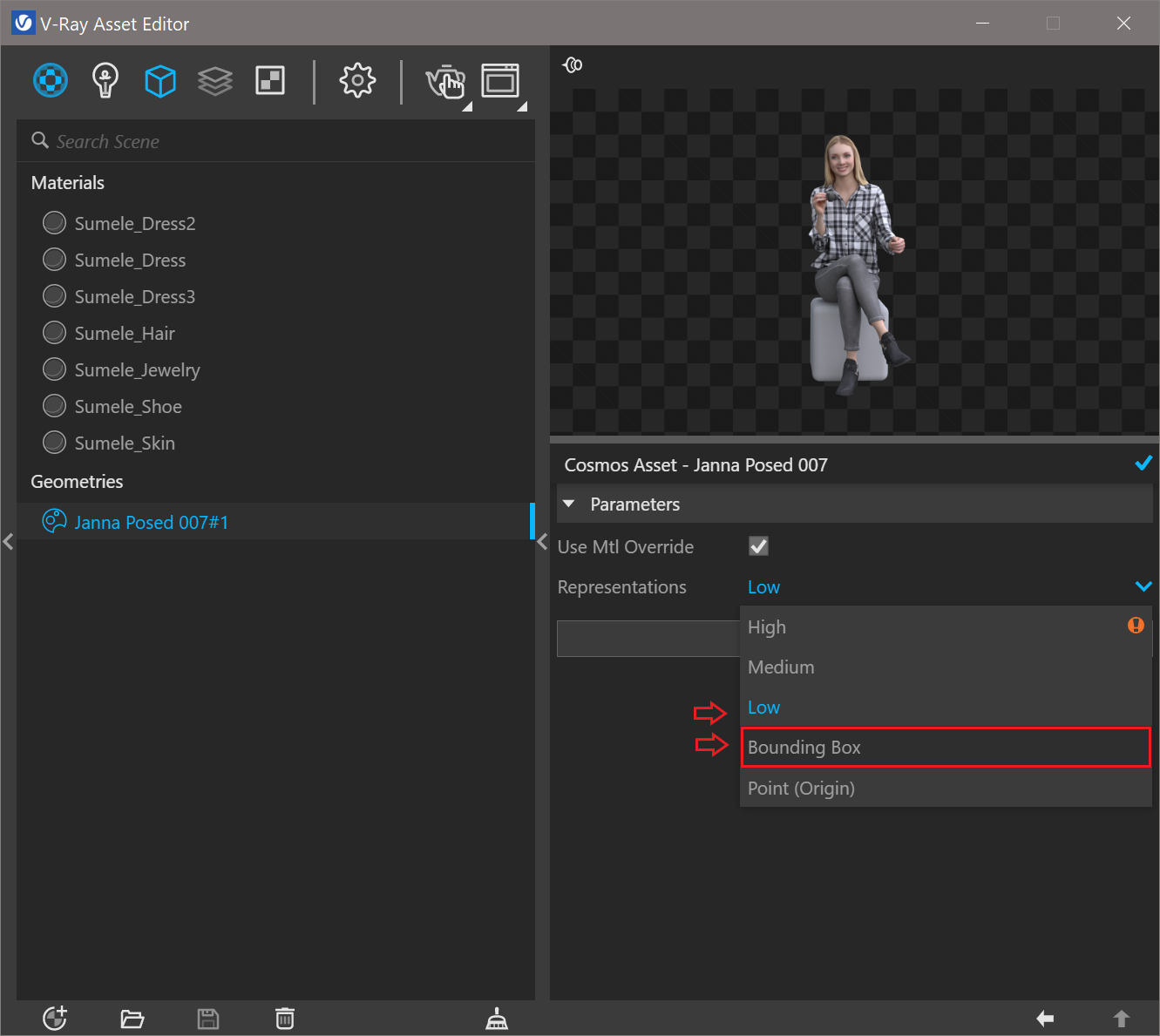

            Your issue seems to be caused by misplaced Cosmos assets preview geometry - the rendered result is the correct one.
            I'm not sure how this misplacement happened.
            It seems you've entered the Cosmos asset Component and moved the faces inside.
            Note that the same can be done for other proxies.
            In any case you can refresh the cosmos asset previews by selecting each one and changing its preview type.
            You can select Bounding Box and then go back to Low.
            You'll then see the actual position of the asset.
            Hope that helps,
            Konstantin
