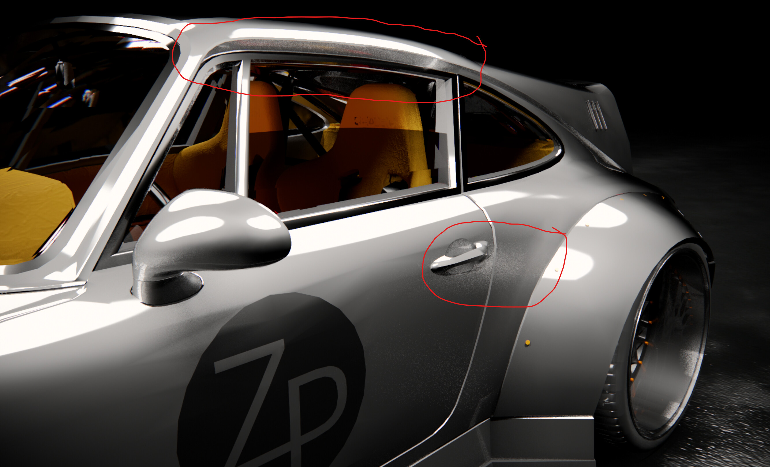

  1. Transparent textures;
How do I achieve an actual frosted or textures transparent finish to a material. Or maybe I’m asking for semi-tans? Everything I do doesn’t retain a frosted of high refractive effect? See badly marked up render noted B. Further to that, looking at the front view vs the rear, theres lots of reflection from the interior on the rear shot which shouldn’t happen, but the front is fine? I’ve applied the material finish to a group or component and not a surface so this shouldn’t be an issue still, no?
Second question, speckles or pixelation of certain areas of surfaces. I as many have experienced this with other software as lighting issues or under-rendering? Is there a term for this? It happens a bit in small areas and I want to k ow what I’m doing wrong to cause this.
Front shot attached for reference of transparent finishes to shot what i’m looking for currently.

I should add I tried bumps to the rear lights and it seemed the transparency prevailed so I can see very little.
I think it’s the reflection of the floor, trying indirect light like in a studio photo shoot.
i guess in the interior you got a light the same effect in the photography, especially if the background is deep black.
