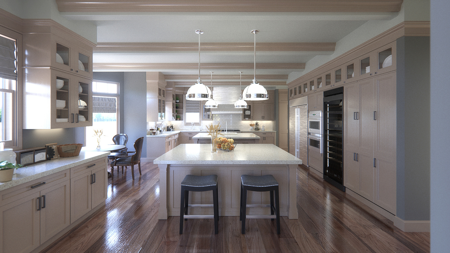

Here, is an update. It took longer to render than I would have hoped for, so this is 1/2 resolution. This still took 4hrs 50min at 1920 x 1080 using BF + LC
I am using V-Ray 3.30.03 V-Ray SkyDome and V-Ray camera. Why it took so long, I don't know, so any suggestions would be appreciated.
