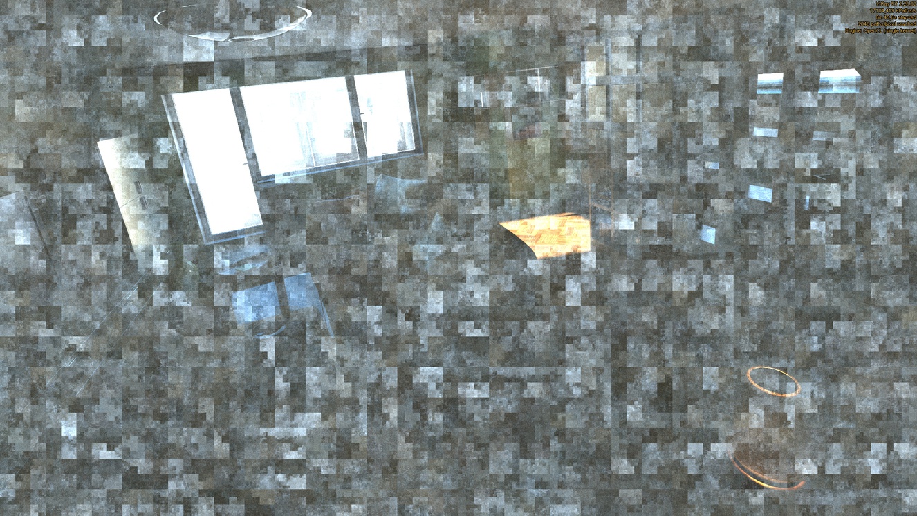

580+680-GTX_1080p 6min45sec NV301.10_crippled
I dont know why... havent tried a second attemp, but somehow this one sadlygot crippled.
It was in the first steps working fine, and also the KPaths/s made sense (roundabout 2900) then this...
after that I was no more able to rerender this until I was restarting MAX.
I've a GTS450 (for now) and with this test scene only with drivers until 275.33 it's ok, but with newer driver i've this problem.
Any tips?
I've already tried, but nothing!
vray have an error similar to:"driver api error"
Ok, vray version 2.30.02 and nvidia driver 301.42
OpenCL test: after few minutes the monitor goes black for some seconds, and after vray rt returns this error
Error Invalid command queue (-36) at line 224 , in file ./src/ocl_tracedevice.cp
p !!!
Error Invalid command queue (-36) at line 651 , in file ./src/ocl_tracedevice.cp
p !!!
Error Invalid command queue (-36) at line 1120 , in file ./src/ocl_tracedevice.c
pp !!!
Windows error details:

Cuda test: after few minutes the monitor goes black for some seconds, and after vray rt returns this error
./src/ocl_tracedevice.cpp<1120> : Driver API error : 999
./src/ocl_tracedevice.cpp<655> : Driver API error : 999
./src/ocl_tracedevice.cpp<224> : Driver API error : 999
