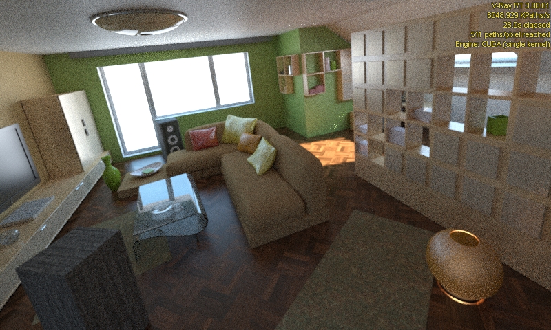

      Here is my GPU test with 3 Quadro K6000.
      36,4 seconds
      www.3D-Vizual.dk

          • What is the preferred ray bundle size and rays pr pixel. if you have a lot of GPU power.? is this 512 in bundle size and 32 in rays per pixel.?
            www.3D-Vizual.dk
            • Originally posted by 3dvizual View Post
              256/16 seems to work pretty well in the majority of cases; 512/32 might be able to utilize the GPUs a bit better.
              Vlado
