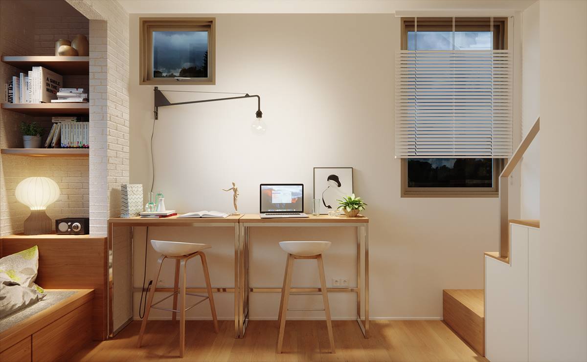

    check this out

    • Yes those renders are absolutely amazing
      It's hard to find that good renders in Vray, even in the Vray World group where a lot of renders are already great

            • Having worked with both I can say that the RT of FStorm is just way faster than Vray's and thus you work faster and get the result you want way quicker.
              If it was just a filter, well count the time you spend in PS and let me know if that would not be good to pass that time doing something else you'd love to do in stead...
              At the end of the day, even if all my images where looking like these, well that's absolutely fine by me :

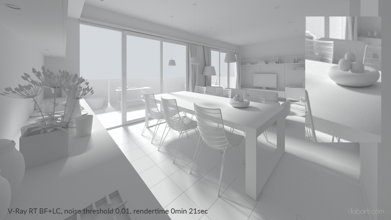

                          • I love GPU rendering and all the goodies it brings to the table. After I've seen some statements that FStorm is very fast it made me curious. I tested and it isn't faster than RT. In my opinion the best thing about it is that it forces users to actually render on GPU and see how interactive setup and fast feedback can help in day to day work. This doesn't mean you cannot do the same with RT.
                            ps. After seeing over years how V-Ray's development goes I am very confident that if there is any aspect of FStorm that performs better, V-Ray will soon match or outperform it.
