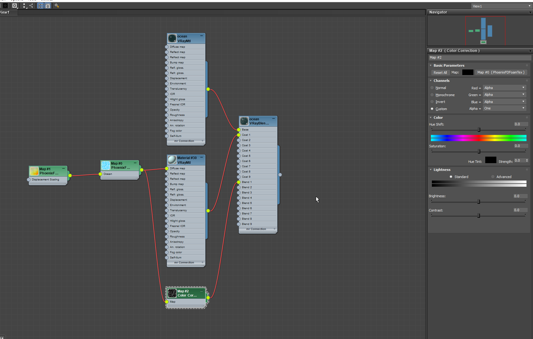

                        • Hey guys, I too now am trying to do a boat in water! I followed the Phoenix Ocean tutorial along with starting with the Ocean preset, which probably is the cause of my problems. The water quality is great, but I can't seem to get my foam and mist to show up. I don't know if it's an issue with the preset, or what. Also, I added a foam texture to my ocean following using the blend mat and CC alpha and it doesn't create foam crests, rather it makes the water generally whiter...can't figure that one out either. Would love your guys' help! I'm sure it's something basic and easy. I'm also wondering if I should be using Bubbles mode and Splashes mode in the PHXFoam objects (the preset creates 2 which I assume is good.) Would it be better to use Point and Splashes?
                          • I started from a fresh scene and am working forward... slowly changing settings. I think some of the numbers just didn't work right from the tutorial in the foam/mist settings from Phoenix 2 to 3 and eventually it got all screwed up, but still wondering why the foam texture isn't working right...
                            • Ok, just to be sure would you animate a sphere and add an Ocean preset? Simulate some frames, rend them and share what is going on with the foam.
                              Thank you!
                              • Also, it seems like the foam amount is just too low. If you are starting out with the Ocean preset, you shouldn't need to make any drastic changes to the simulation settings. The foam texture on the other hand looks like it needs some mapping changes - can you share the params of the foam and the ocean maps?
