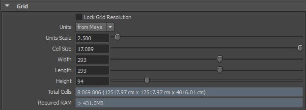

                • Hi,
                  I started again with some basic testing of the seat preset and rolled back to Maya 2014. At the beginning I thought that Phoenix for Maya2017 would be more stable/efficient, but it doesn't seem so.
                  As I prefer much more Maya2014, I'll be running my new tests from there.
                  So, I decided to make some simple tests, with a simple Ball at different sizes, just to see what happens, how the grid is defined and how it looks.
                  I know that these tests are not exactly comparable as I changed a little my mind, during the testing, on how to setup the scene. In the beginning (starting from the 1cm ball) I used a movement based on the size of the object (and with a grid following the object), and then changed to have a movement of 10knots regardless of object size (and with a static grid). I should probably redo the first three with a 10 knots movement.
                  ALL scenes are based on a centimeter setup in Maya (1 Maya Unit= 1 cm)
                  It's quite interesting to see how the grid changes. Remember: each time, Ball is created and then quick preset is pressed to create the ocean.
                  The best effect is given with the 5m Ball (in my point of view), but the Grid itself (units scale, cell size, Total grid size) makes no sense to me...
                  I would like to have the setup of the grid differently. The Width, Length and Height size should be specified in system units (so I can think how big I want my grid around my object), and then I can give a cell size (and it tells you how much cells will be created), or maybe even just a precision/definition parameter. Units scale would be just there to exaggerate or damp the effect. Makes that sense?

                  • Hey,
                    Using the toolbar presets, you should get identical results no matter what scale you use. We should investigate the differences between the first 3 scales and do some changes - thanks for noting this!
                    The presets try to compensate for the scale of the scene, so the simulation would produce the same result no matter what. This is done by automatically adjusting the Units scale coefficient. The ocean preset is designed to look right when an object passes through the simulator in about 15-20 seconds, so the scale is adjusted so that the object would be roughly the size of a ship.
                    Definitely gotta rename the Width/Length/Height - this way they don't say much about what is actually going on.
                    Cheers!

                      • Hey,
                        I should explain the motivation behind the toolbar presets in more details. The toolbar is just a starting point - I don't expect that a person would pick Phoenix for the first time and know he's supposed to work in real-world scale or any of the specifics, so this is why the toolbar has to make the job as easy and straightforward as possible - you shouldn't fail with the very first click of a new software because you didn't know things that you are not really supposed to know until this point
                        With time, once a person learns what the unit scale does and how the sims behave on a low and high scale, he can alter them manually, like basically all the other simulation parameters. The Ocean preset would work as a starting point when setting up the ocean texture, the material and the general splash and foam settings, but if you want to make a small-scale water splash, it's not the right preset to start with in the first place. Another reason for the way it is right now is that most of the presets on the toolbar would not look good if they are simulated on half or double the scale, not to mention if the scale is a a thousand times off, so this is the reason the scale is always adjusted for those.
                        In fact, I've also thought about a dialogue that would ask you for the correct size of the simulation when you select a preset, but actually changing the unit scale manually is all that this comes down to, so I've left this out for now, until we gather more ideas and feedback.
                        Thank you very much for raising this interesting topic!

                          • Yup, this behavior is expected with the Ocean quick setup - you can see how the unit scale changes for each setup to adjust for the scale of the objects, so each one would act like you have a meteorite running through the water at high speed
                            • Originally posted by a0121536 View Post
                              Maybe stupid to ask, but when I change the "Unit Scale", does it affect everything in the simulator or just the grid settings ?
                              PS: I still don't really agree with the quick setup, even if I understand your point. Maybe a simple warning "your scene needs to be properly scaled" would make the trick for those who start with Phoenix...
                              www.mirage-cg.com
                              • Ah, yeah - it does affect everything related to gravity or scale of the effect of sources.
