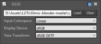

                    • #55
                      cool thanks alot!
                      very high contrast, even the basic one...maybe for that I have to render out even flatter...
                      I was thinking that I should maybe aim for a LOG-like rendering to have more control in post.
                      anyway, see the screen attached. Should there be more controls than those three?
                      Add Your Light LogoCheck out my tutorials, assets, free samples and weekly newsletter:
                      www.AddYourLight.com
                      Always looking to learn, become better and serve better.
                      • #56
                        looks good. “view transform” dropdown shoul contain all included contrast options (looks).
                        you don’ have to “aim” for flat rendering - with default color mapping settings and PBR shaders VRay will give you “flat” look on 8 bit display. blacks will be “milky” and highlights will be well above value possible to display. to fit it nicely to this display you need S-shaped curve (by whatever means available) - blacks will get deeper and highlights will be compressed to fit 0-255 sRGB range.
