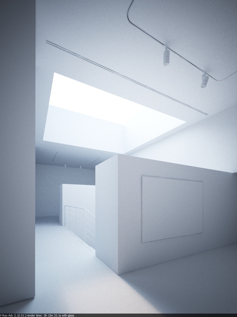

      single glazing or double?
      www.peterguthrie.net
      www.peterguthrie.net/blog/
      www.pg-skies.net/
      • #93
        single is fine

          Peter one more question:
          Subpixel mapping is on or off?
          for my blog and tutorials:
          www.alfasmyrna.com
          • #95
            subpixel mapping off, clamp output off and dont affect colors off (i rarely do anything in post)

              here you go, glass has a very slight amount of fog. Didnt take much longer to render
              www.pg-skies.net/
              • #97
                Thanks Peter.
                I see that there is not any noise problem regarding glass. Then there must be something in my scene triggerring the noise.
