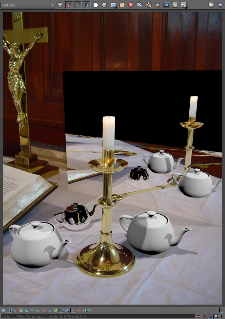

                  Hi Tashko, I've attached both Vray 2.4 (Maya 2014) and Vray 3.0 RC (Maya 2015) scene files here candle.zip.
                  The shadow is missing in reflections as you can see in test renders of my earlier post. I wonder how Vlado achieved the correct result?
ID:	854255 my render
ID:	854256 Vlado's render
                  always curious...

                      • #71
                        Edit: The setup that Vlado used didn't involve neither diffuse nor self-illumination slot. It uses a new Matte For Secondary Rays option called Projection Mapping which unfortunately doesn't work in Maya. For now the only option to get similar result in Maya is to use projected-texture inside diffuse slot.
                        We'll make a note about it into our system and we will inform you when we have some updates on that matter.
                        • #72
                          It actually works fine - I have forgotten to plug the background image into Reflection/Refraction slot.
                          There is no need to plug any maps inside the Base Material of the Wrapper. What is important is to set Matte For Secondary Rays option = With Projection Mapping and to plug the Background texture inside Reflection/Refraction Environment:
                          Scene:matte-projection-mapping_01.zip

                            Hi Svetlozar,
                            Thank you for the explanations. I was able to re-produce the desired result with GI "disabled". I would like to confirm couple things:
                            1. I noticed some artifacts/noise when GI is enabled (BF+BF, image sampler threshold 0.01), which breaks the 1-to-1 match. Is this a bug?
                            2. Can the same result be achieved in Vray 2.x?
                            Thanks.
                            always curious...

                                Hi Svetlozar,
                                [QUOTE=svetlozar_draganov;632774]1.Can you send us a scene/screen-shot with GI enabled?
                                Here is the scene file matte-projection-mapping_01_withGI.zipwith GI enabled. I've also applied the VrayMtlWrapper to the candle.
                                The below are two renders for comparison:
                                no GI.
                                with GI enabled (BF+BF).
                                I have the "No GI on other mattes" enabled in the VrayMtlWrapper, but it doesn't seem to work and yielded bounced light onto the Candle, which is also the matte surface in the scene.
                                Thanks.
