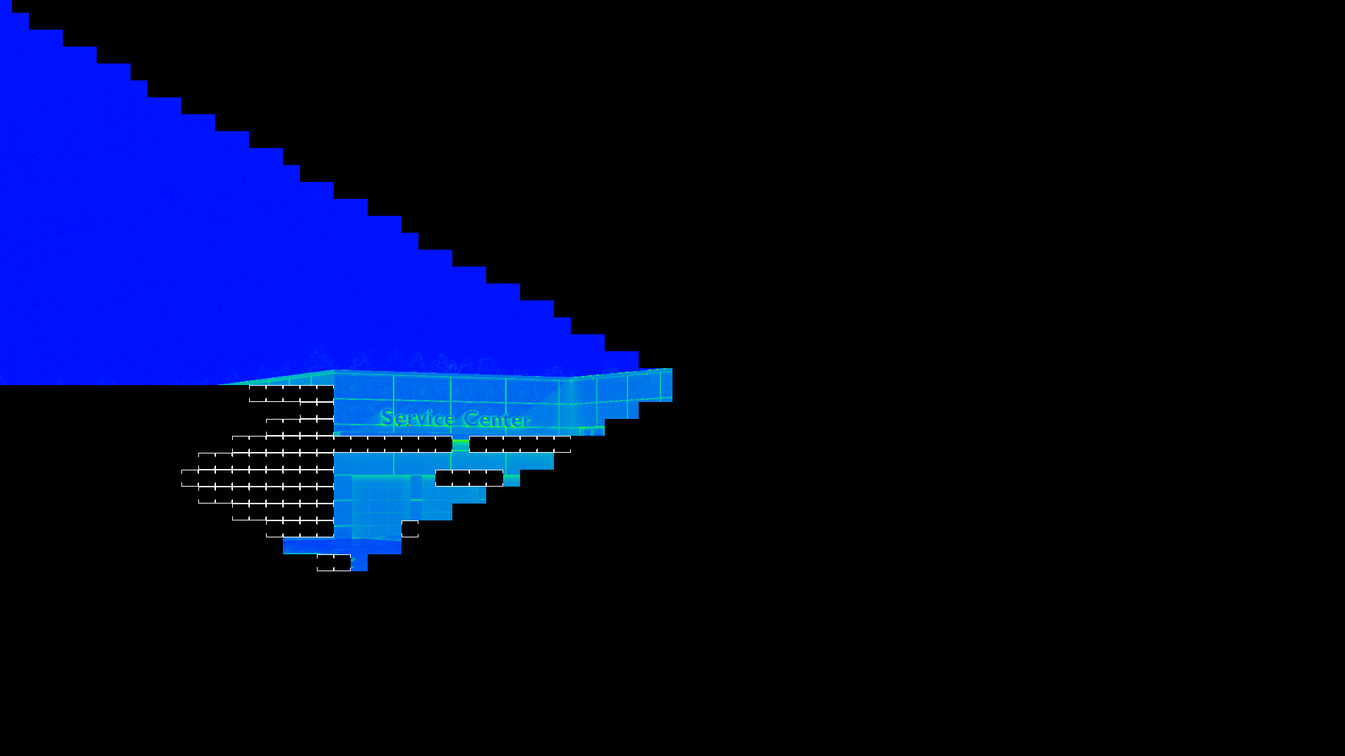

    It's been a long time since I had this issue. I have an image that is stuck on 1/2 dozen buckets. Nothing special about the scene and the buckets are not sitting on anything out of the ordinary. I am going on 27 minutes now, with things stuck.

      I ended up killing it after no movement for 1/2 hour. I tried clamping and sub-pixel, but no good. I am using a V-Ray Sun, HDRI, Physical Camera, Forest Pack Pro, and Rail Clone. The stuck buckets were on the asphalt and the cars.

            Okay, it looks to be doing the same thing. This was due 4 hours ago. Don't make me pull out Corona!
            Really, what do I do? The sun was visible, but now it isn't and it is still getting stuck in a very random way.

              Those 4 buckets, under the Honda logo, are consistanly stuck. Althought the scene isn't done, the random buckets you see in the field, will not move. I'll let it bake for awhile, but seriously, this is insane. New client, first project...sucks!

                            Turning off reflection caustics got me past those 4 consistanly bad buckets. I'll let this run for a while.
