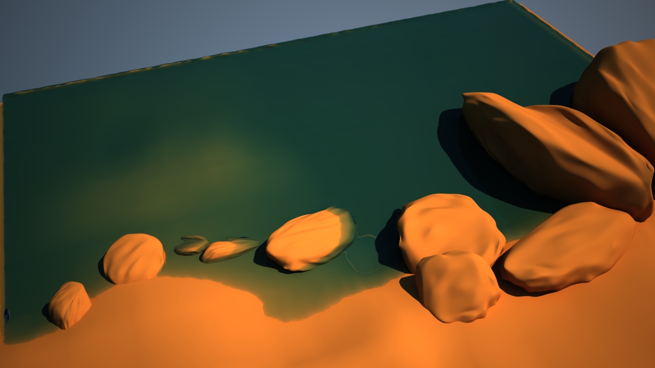

              Yes, no problem rendering bifrost if the meshing is enabled. This is with VRayMtl:
              I'm not sure about this splotch next to the rock though, seems like intersection issue.
