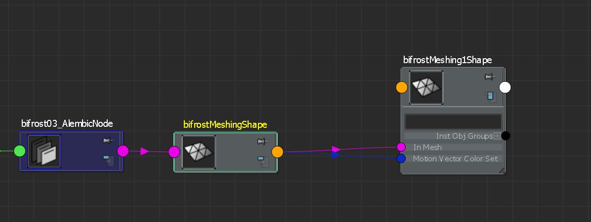

            Heres a clarification for anybody else interested in doing this, you create a new mesh node and from the bifrost mesh(contains a velocity color per vertex channel) you plug "outmesh" to "inmesh" and "colorsetName"(not "colorSet") to "motionVectorColorSet" Click image for larger version
ID:	852031. Now turn on motionblur and youre good to go. As mentioned before the MB default is extremely strong so really need to dial that down, might be a better way than tweaking duration, maybe just multiply the values down or something?
