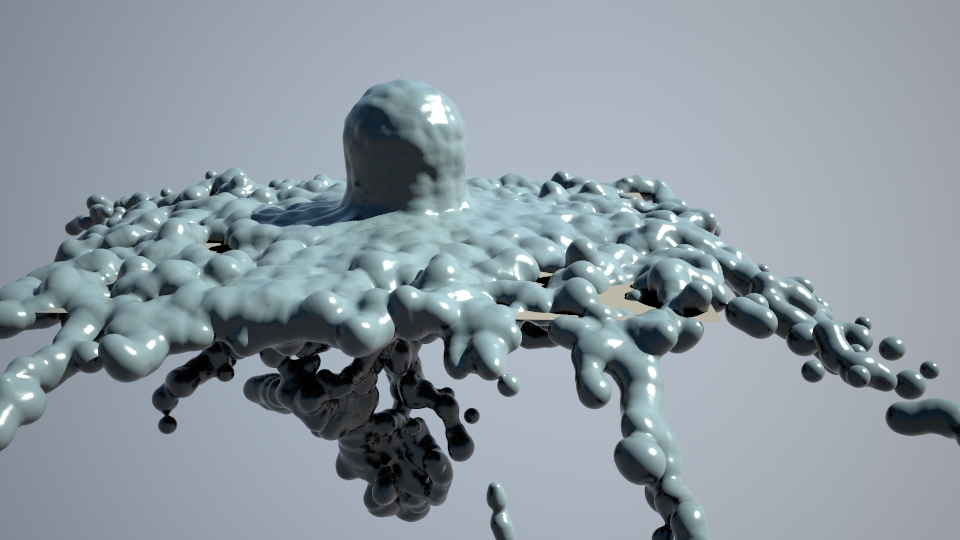

    I can confirm, Bifrost + Metaballs will work in Maya 2016

        The new Bifrost support is not even in the nightlies yet. Basically we have the liquids working, both with metaballs and direct isosurface rendering. I'm still working on the Aero support, but it's shader looks very similar to our VRayVolumeGrid, so hopefully everything will be done for the SP. Autodesk decided to totally change the Bifrost material in 2016, so it doesn't render right with VRay yet.
