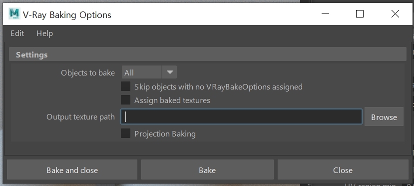

    Looks like that the latest V-Ray 5 for Maya has an issue with baking textures for multiple objects.
    V-Ray just bakes a texture for the first objects properly. There are just black textures for the others.

    2. V-Ray Baking Options

    vray_adv_51020_maya2020_x64
    BTW, there is no problem with V-Ray Next for Maya.
    Thank you.
    Best Regards,
    Thanks for the report. The issue is reproducible and I've logged it (internal bug-tracker id: VMAYA-10545) for developer analysis.
