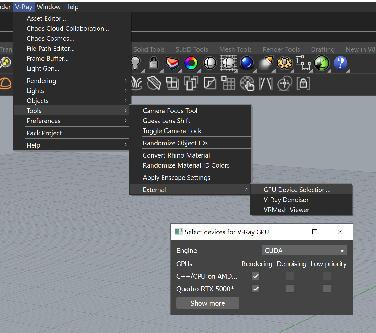

                    Hi everybody,
                    We identified a specific scenario that leads to a GPU crash.
                    It is caused by a specific configuration of the devices V-Ray uses for rendering.
                    There are basically 2 places where the devices selection can be altered:
                    1. The default environment variable, controlled by the GPU device select external tool:

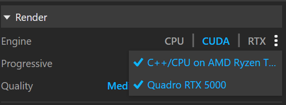

                    2. The device selector in the Asset Editor
                    It appears that if in the external tool, both the CPU and the GPU are active while in the Asset Editor only the GPU is active, V-Ray crashes (on the second render).
                    I would suggest that everybody experiencing the crash tries the following workaround:
                    Ensure that the configuration in the external tool matches exactly the configuration in the Asset Editor.
                    If you want the CPU disabled, make sure it's disabled in the external tool before you start Rhino.
                    Note that we already have a fix for this but I want to ensure that this solves the crash for everybody.
                    Thank you all for the assistance!
