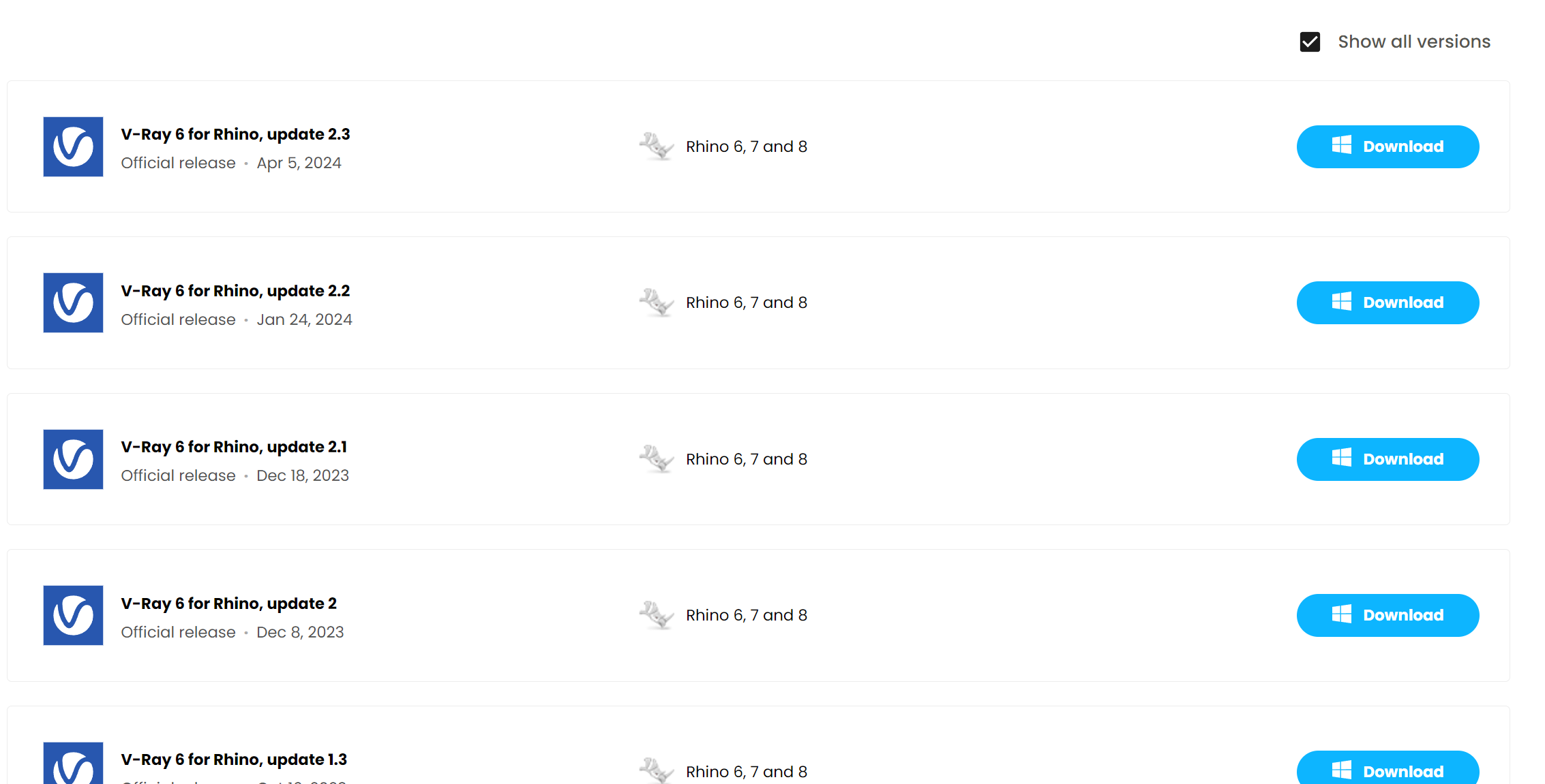

      Which V-Ray version were you using before the update?
      Keep in mind you can always go back to it.
      All of the older official V-Ray 6 versions are available​​ on our downloads page (enable the Show all versions checkbox to see them).

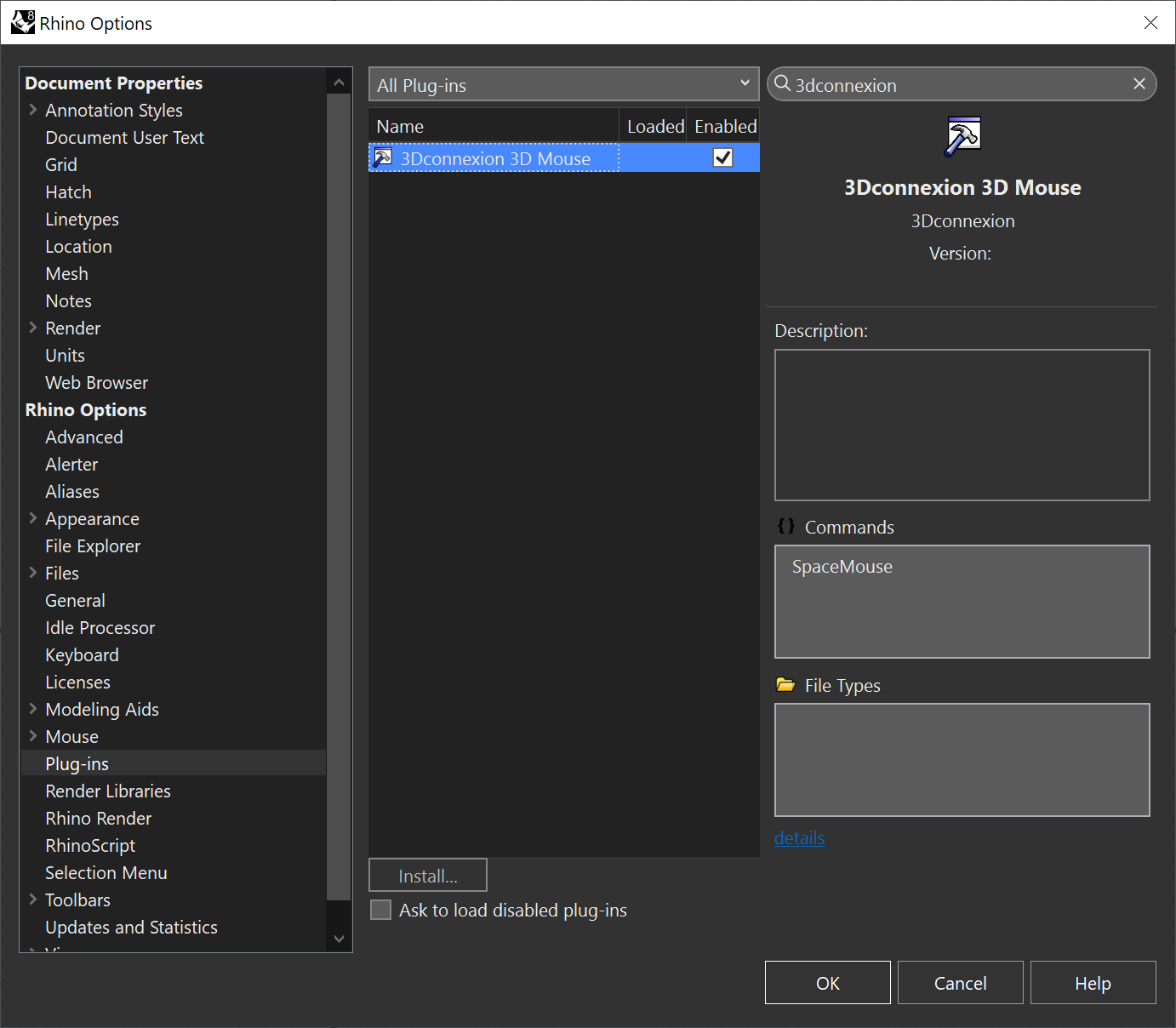

          Have you tried disabling the 3D connection plugin?
          If that prevents the crashes in your case too, it gives us another clue.
