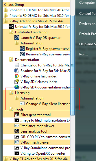

    Since I have installed the new VRay, there is no longer a "Launch Vray License Server" icon to click. I also don't see an executable for one anywhere in the Chaosgroup Program Files folders.
    - Geoff
    • #47
      See attached.

        If you installed full V-Ray with the License server then it should be in:
        "\Program Files\Chaos Group\V-Ray\vrlservice.exe"
        you should be able to launch the license server from there, if those files are not there you might have to reinstall and double check its installing the license server files.

          Ok, I'm an idiot. In all my desperation to get the dongle working at one point I had told the VRay installer to look for the dongle on my other machine. So every time I re-installed it, the installer defaulted to the network settings.

            Please uninstall V-Ray manually either from Programs and Features or from Start Menu > ... > Uninstall V-Ray and run another installation.
            Then run the installation again and pay attention to any errors/warning and etc during the installation.
