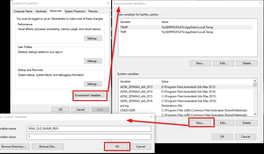

    • #17
      In order to set that environment variable please follow the steps:
      Right click on My PC/Computer then Properties > Advanced system settings
      I have a screenshot for the next steps:
Name:	2016-03-21 17_17_31}.png
      Tashko Zashev | chaos.com
      • #18
        Thanks. I did exactly that but it didn't work. Did I have to restart my PC for the changes to take effect? I didn't so maybe there was the problem. :/ We're in the middle of a long animation at the moment so I'll try it out as soon as it is finished.

        • #19
          Restart the 3d platform only.
          • #20
            you'll probably need to do that for the whole farm tho
            • #21
              This should be better in the latest nightly builds and for the 3.40 SP in a few days.
              Vlado
              • #22
                Vlado
