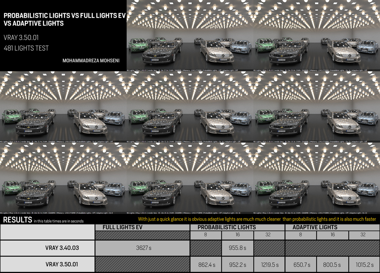

              Probabilistic Lights vs Full Lights Ev vs Adaptive Lights
              481 Lights
              With just a quick glance it is obvious Adaptive Lights is cleaner by far in comparison with the Probabilistic Lights and also considerably faster.
              I did not render full light with vray 3.5 because in testing it was really close to 3.40.03 so I canceled it in middle of the render. In addition, with this much light source, full lights are not in the same league with Probabilistic Lights and Adaptive Lights obviously.
                      Thanks for these tests! It's very useful information
                      Vlado
