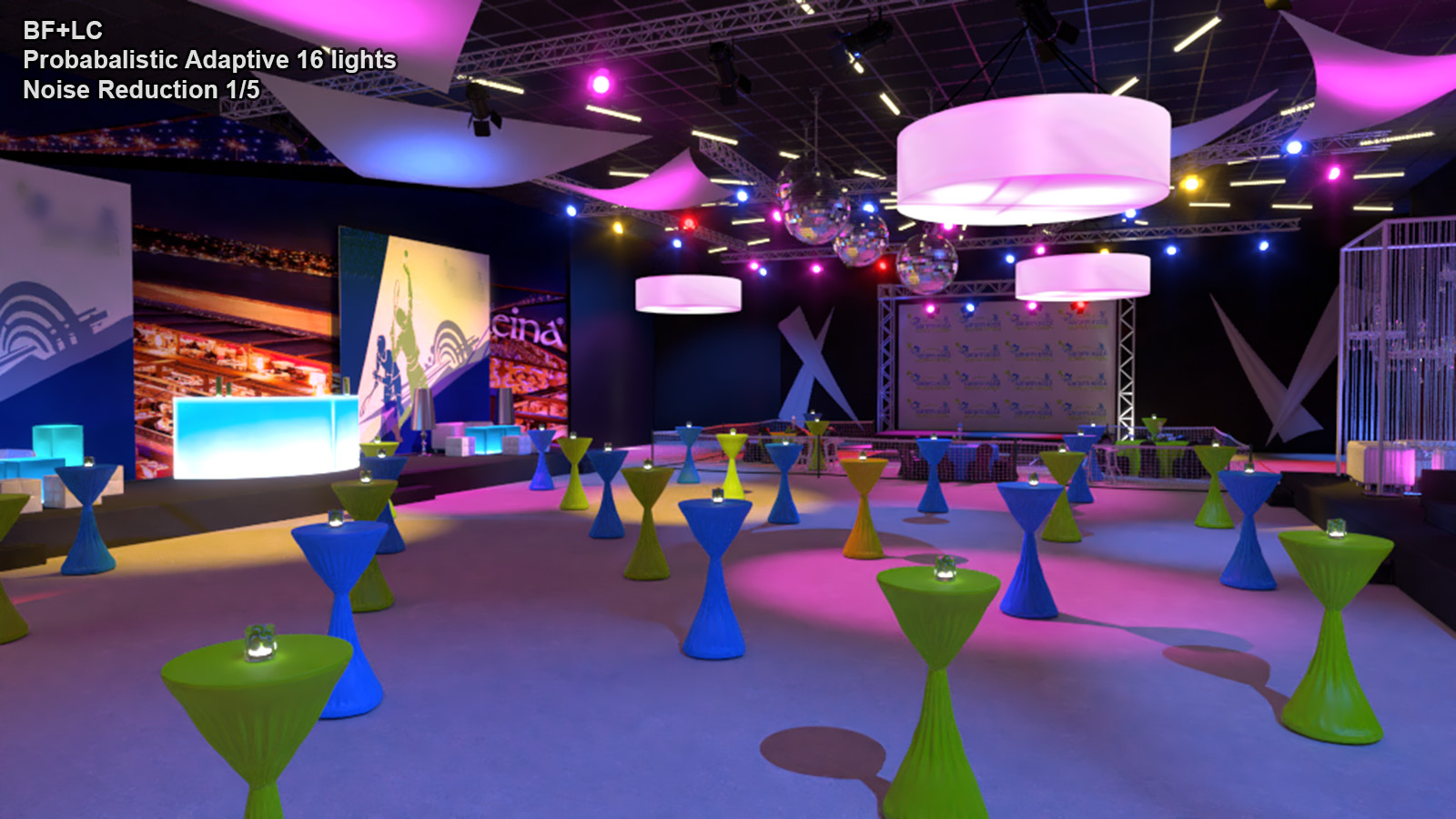

        I conducted some tests. Here's a scene with 106 lights (80% IES lights, 20% regular lights). It was rendered on 2 x i7 4930k with progressive sampler set to 4 min. limit. You can see the settings used for each image in the upper left corner. You might want to save them on your PC for better comparison.
                Thanks for these tests! Based on the forum feedback and some more internal tests, we have more or less figured out good default settings for beta 2.
