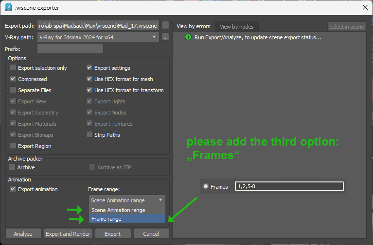

                export vrscene -> please add the possibility to enter single frames, e.g. 1,2,5-8
                Thank you
Name:	Dialog 3 Frames.png

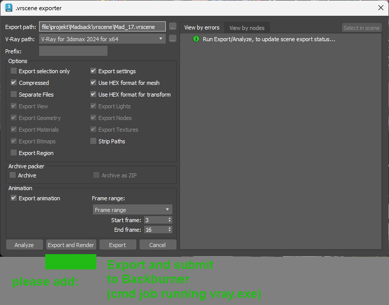

                • #83
                  export vrscene and submit to backburner as a vray.exe cmd job
                  so that you can render a queue of vrscenes at night.
                  Gladly with options like:
                  - initially suspended yes/no,
                  - chose a existing dependence job
                  - use all nodes or chose a specific render node
                  Thank you
